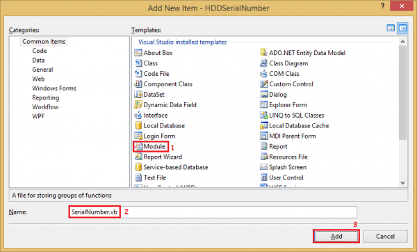

Here are the steps. First I created a windows form project/solution named HDDSerial Number, add a module name SerialNumber.vb and type below codes:
